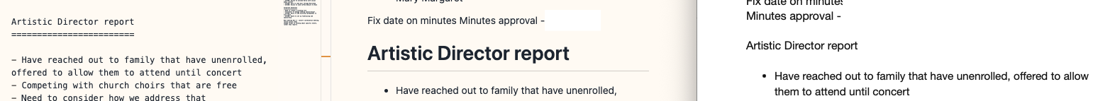

Using the alternate form for headings (=== or --- under the line) does not result in a header, and for the MultiMarkdown renderer, can cause formating down document to break. FWIW, Pandoc seems to be having trouble with this document as well.
Test case.md
Screenshot of similar document in VS Code, with Marked preview on the right.

The answer to this issue was that ==highlight== processing was enabled in Settings->Processor. This issue is resolved for Marked 3, but will be an issue on Marked 2 until I get a maintenance release out for it.
Your file renders the headline for me in both GFM and MultiMarkdown modes. I thought GitHub Newlines might have something to do with it, but that didn't allow me to reproduce the issue either.
Just out of curiousity, what editor are you editing the file in? Any chance the encoding is off or there are hidden characters happening on your end? I doubt it, as I used the raw file you uploaded for testing without making any modifications to it, but would be worth knowing.
Please hit ⌘U in Marked and show me what the HTML source looks like.
File was created in BBEdit 15.5.2, and edited in VS Code 1.107.1. UTF-8 with LF line endings. HTML below.

Does anything change if you add or remove an = from the Setext row? It's so weird that it's narrowing it down to 1 = character and treating it as a paragraph. If anything, if it weren't processing Setext headers, it would make the ==== part of the preceding paragraph.
Do you have rendering of ==higlight== text enabled in Processor settings?
Kind of. It would render a hard rule at different lengths.
I did, and that was it! Thank you!
