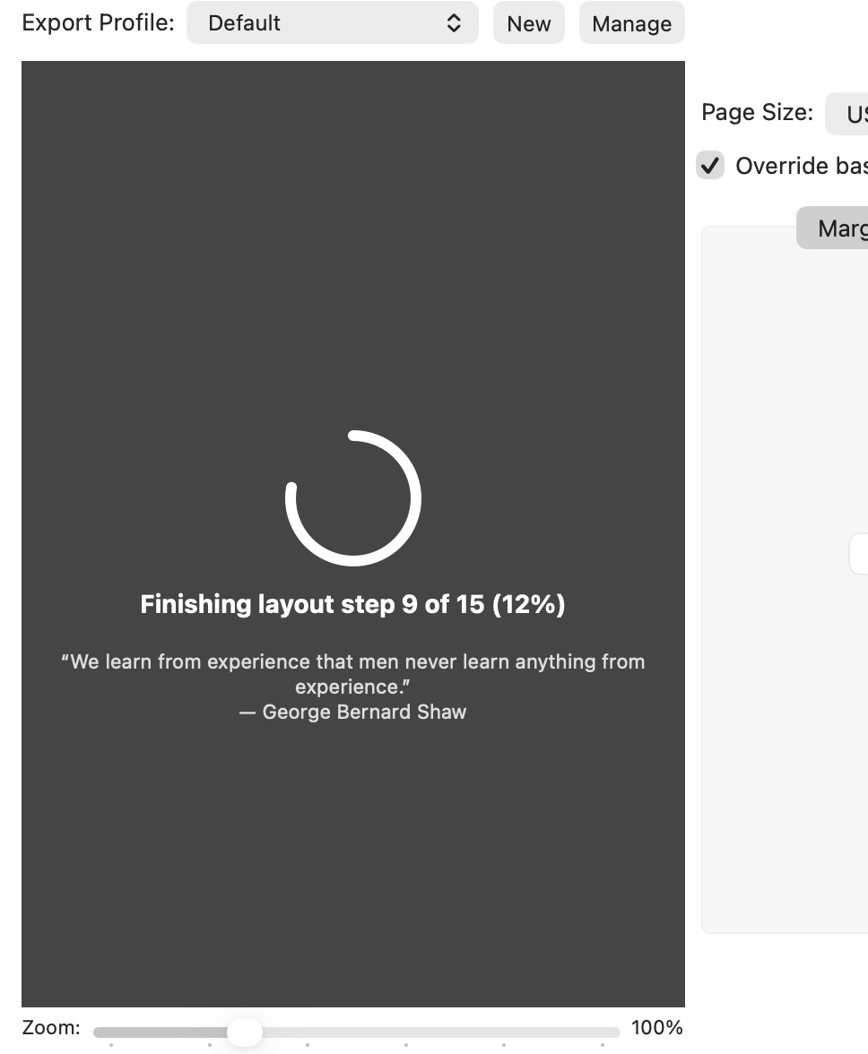

Here is a screenshot with the step that it hung on when processing all 400 pages or ~120 MD files.

OK, back from travel and took a deep dive into this. I think I've made good progress. While I was in there I added handling for the Bear comment/JSON image attribute format, but that's not heavily tested yet.
Could you try this build and let me know if things go any better? Step 9 still takes about 3 minutes on your birding document for me, but that's a big step forward.
https://assets.markedapp.com/Marked1193.zip
