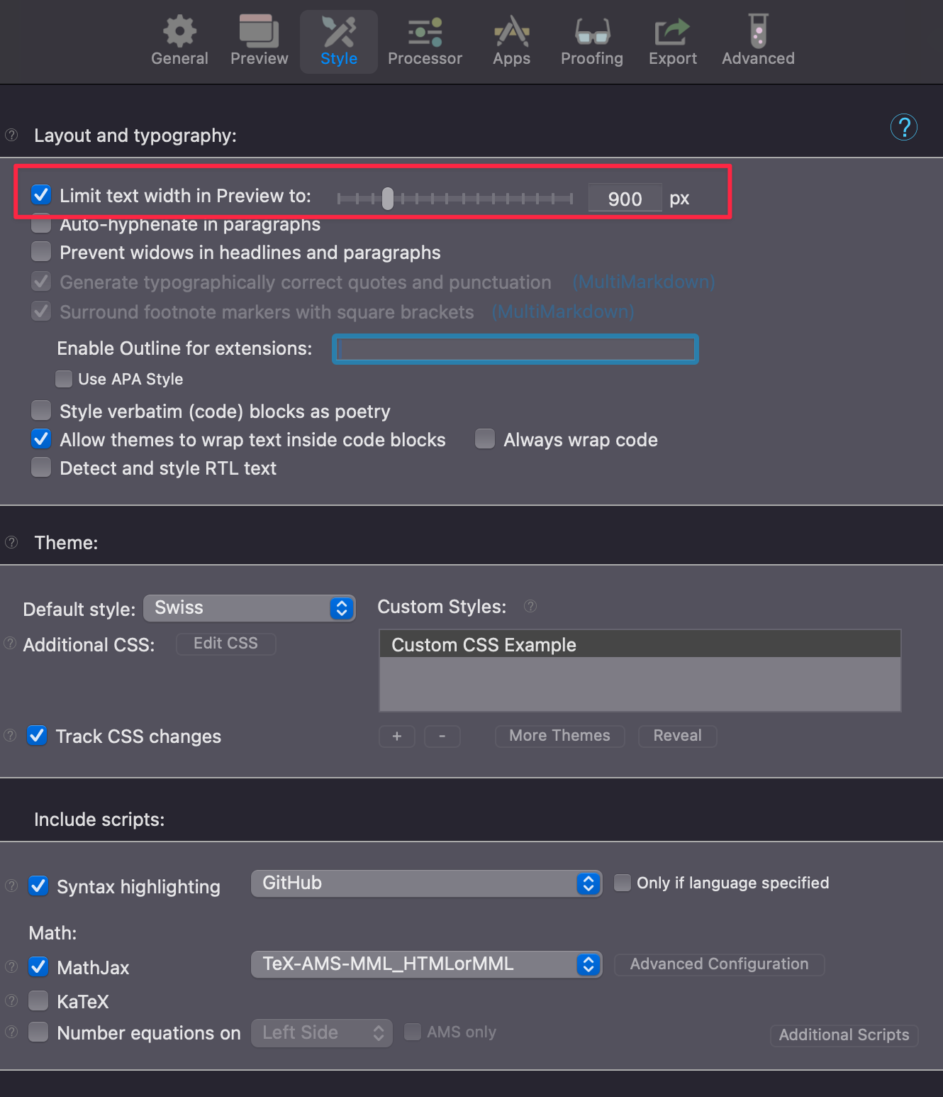

hey for me, when i enabled this option, it worked however you may need to also update the font size to 12 or more in the "Export" window else the the printed results are shown very small using font size of 10. hope this may help.
Hi @raghu - that did it. As soon as I clicked on that feature everything realigned. Thanks a bunch.

Based on the comment from @raghu , do you have anything set for the text width and base font size override? The content in your preview looks exceptionally wide, I think something is overriding the container width. And in regards to the 3rd question, does this happen with all of the built-in Styles?
