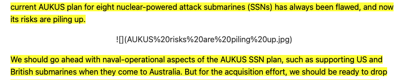

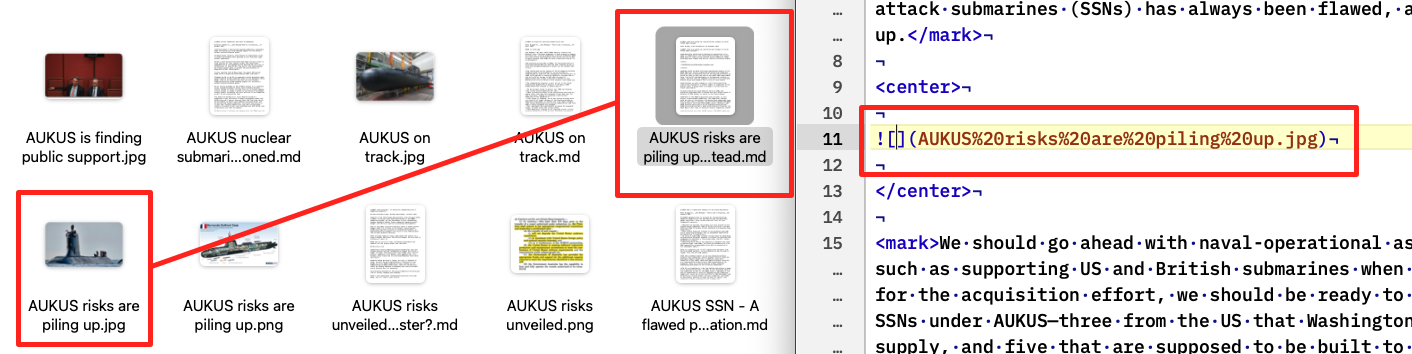

I'm using GitHub Markdown and cannot get inline images to display (see the attached screen shots).

Finder with all files in the same folder:
Output from Marked 2:
This is a different issue than most of the other "images won't display" issues. It's not rendering the Markdown within your HTML (center) tags at all. Which processor are you using?
(the solution might be as easy as toggling "Render Markdown inside of HTML" on the processor page)
